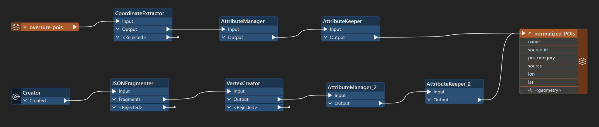

The figure below shows the FME Workbench canvas for the POI normalization task.
Figure 1: FME Workbench canvas for the POI normalization workflow: the Overture branch (top) and Overpass branch (bottom) converge on the normalized_POIs writer.
The top branch starts with the overture-pois GeoJSON file, while the lower branch prepares the Overpass JSON input through Creator and JSONFragmenter. This makes the first difference clear: Each source can keep its own structure at the start of the workflow. Overture already enters as spatial data, while the raw JSON source first has to be split into usable records.

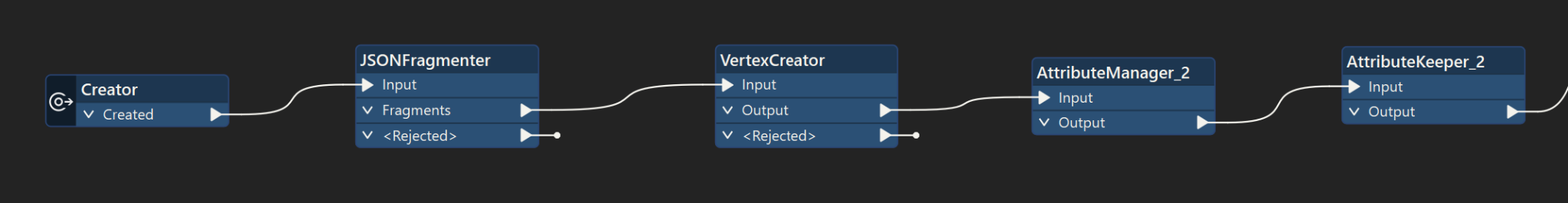

Let’s now see how Overture data is handled. In the Overture branch (Figure 2), CoordinateExtractor writes the point coordinates into lon and lat attributes so they match the target schema. AttributeManager then renames or creates the target fields, and AttributeKeeper keeps only the fields needed in the final output.
Figure 2: Overture branch in FME Workbench: coordinates are extracted into lon/lat attributes before field mapping and cleanup.

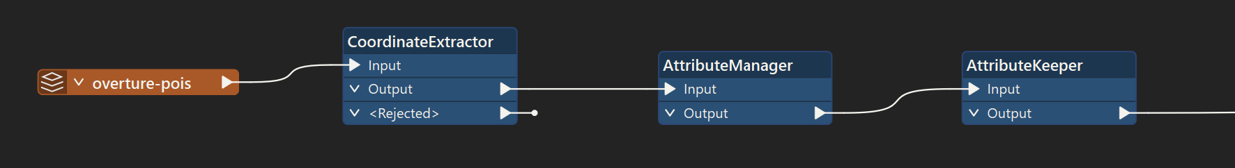

In the Overpass branch (Figure 3):
  • JSONFragmenter splits the raw JSON into usable records
  • VertexCreator creates point geometry and coordinate attributes
  • AttributeManager_2 maps the fields to the same target schema
  • AttributeKeeper_2 retains only the final output fields
This is the visual equivalent of the Python logic that builds point geometry, assigns name, source_id, poi_category, and source, and removes unnecessary fields.
Figure 3: Overpass branch in FME Workbench: raw JSON records are split, converted into points, mapped to the target fields, and cleaned before writing.
At this point, both branches feed the normalized_POIs writer (see earlier figure) with the same target fields: name, source_id, poi_category, source, lon, lat, and point geometry. This is the main advantage of the new approach. The workflow is easier to inspect, rerun, and maintain because the transformation logic is visible. A less technical user can follow the pipeline, check each transformer, and adjust the workflow without editing Python code or maintaining a Python environment.
