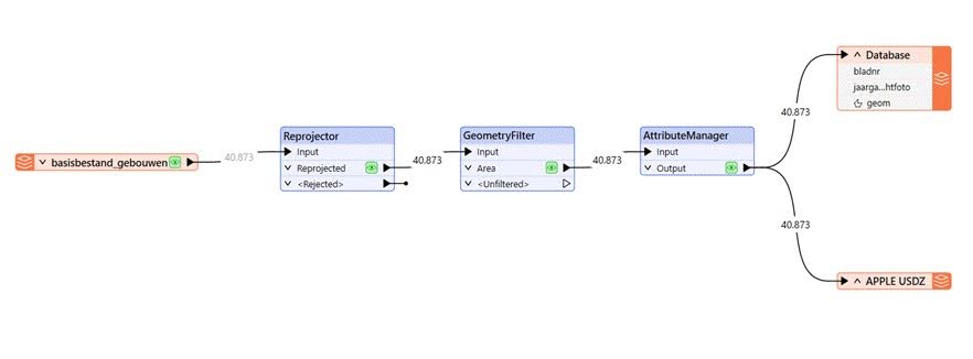

Workflow example: preparing data for an AR application
To demonstrate how AR-ready datasets are prepared in practice, a small example is shown here. For the entire workflow, FME was used to prepare and process spatial data for direct consumption by AR clients and structured databases.

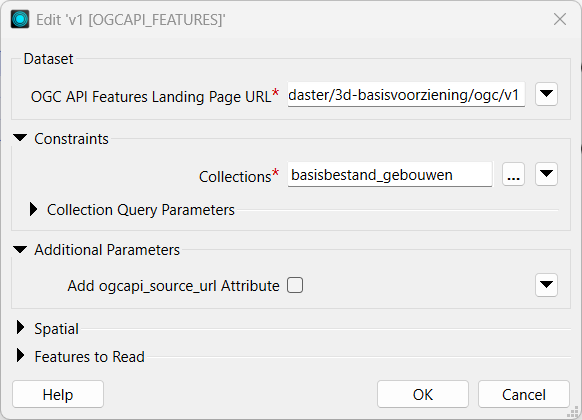

- The workflow begins with an OGC API Features Reader, which allows you to provide an API / URL as input, choose a data collection, and then extract the data for you. This reader fulfills the “Extract” step in this ETL pipeline and targets the 3D Buildings data for the Netherlands from the “basisbestand_gebouwen (basic_buildings)” collection. Reading live data like this ensures the model will always be working with the most recent 3D data rather than static or outdated files.

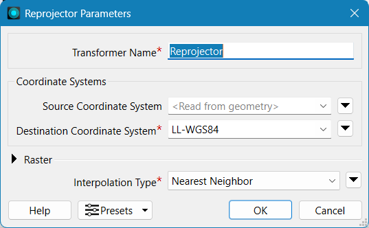

- Standard GIS data from a public map services portal like PDOK (Publieke Dienstverlening Op de Kaart, in Dutch) usually uses local coordinate systems (such as the Dutch RD New, in this case). However, for global positioning and scalability of your project, it is best to use a global standard 3D coordinate system, such as WGS84 (lat/long). The Reprojector transformer in FME handles this step. This transformer can project your datasets to the desired Coordinate Reference System.

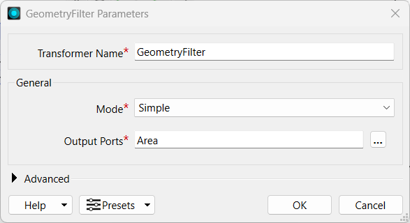

- A GeometryFilter transformer was then used to isolate “area” or polygon geometries (e.g., building footprints) and remove unexpected geometry types (e.g., points, lines, point clouds). Any invalid or problematic geometries are identified early at this stage, before they propagate to the downstream workflow.

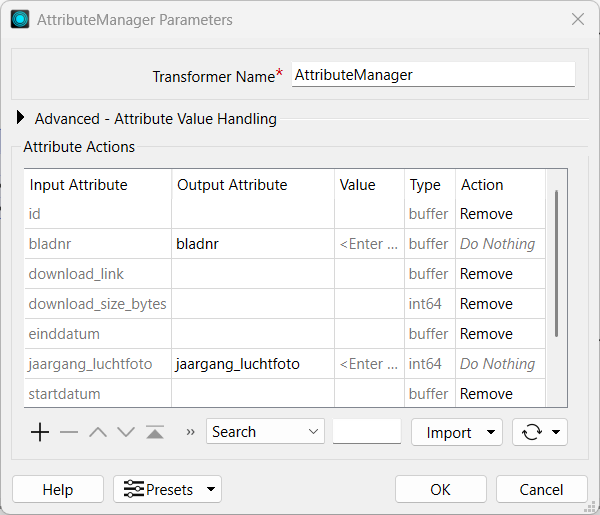

- A “database” can contain lots of information; however, sending 50 columns of unrequired data to an AR is too much. The AttributeManager transformer was used to keep only the important fields: the building IDs and the year when the aerial photographs were taken (jaargang_luchtfoto).

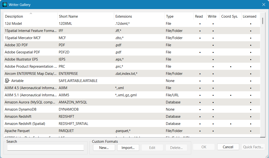

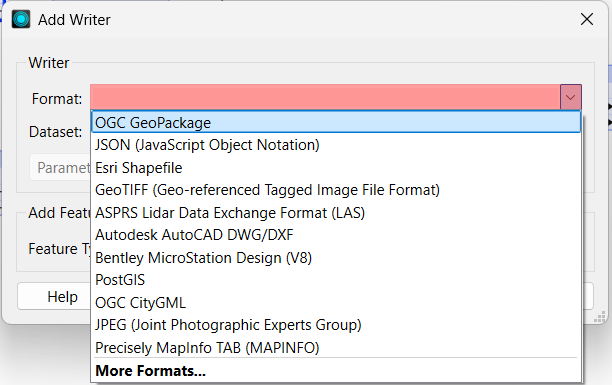

- FME allows you to extract the output of your analysis in multiple formats. For our workflow, the prepared dataset was then written to a PostGIS table with spatial indexing enabled (GiST) and used for proximity queries such as “find buildings near XYZ location.” Additionally, a Universal Scene Description Zip (USDZ) writer exports the data in a format needed for AR rendering workspaces. USDZ format is also widely supported for native 3D rendering in the Apple AR ecosystem on iOS.

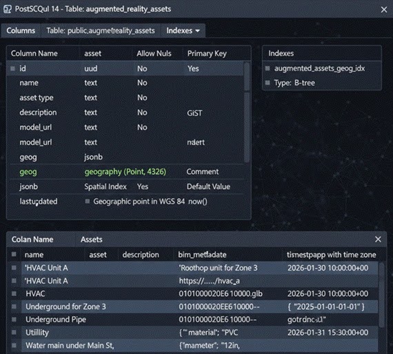

In this workflow, PostGIS stores authoritative spatial data used for contextual filtering or querying, while the USDZ files can serve as the visualization output delivered to an AR client. Both outputs were easily generated within a single automated data pipeline, done using a no-code platform like FME. The model was quick to build (only a few button clicks), and because of its direct connectivity to the live data source, it can be rerun whenever updates are required without rebuilding the entire workflow.
