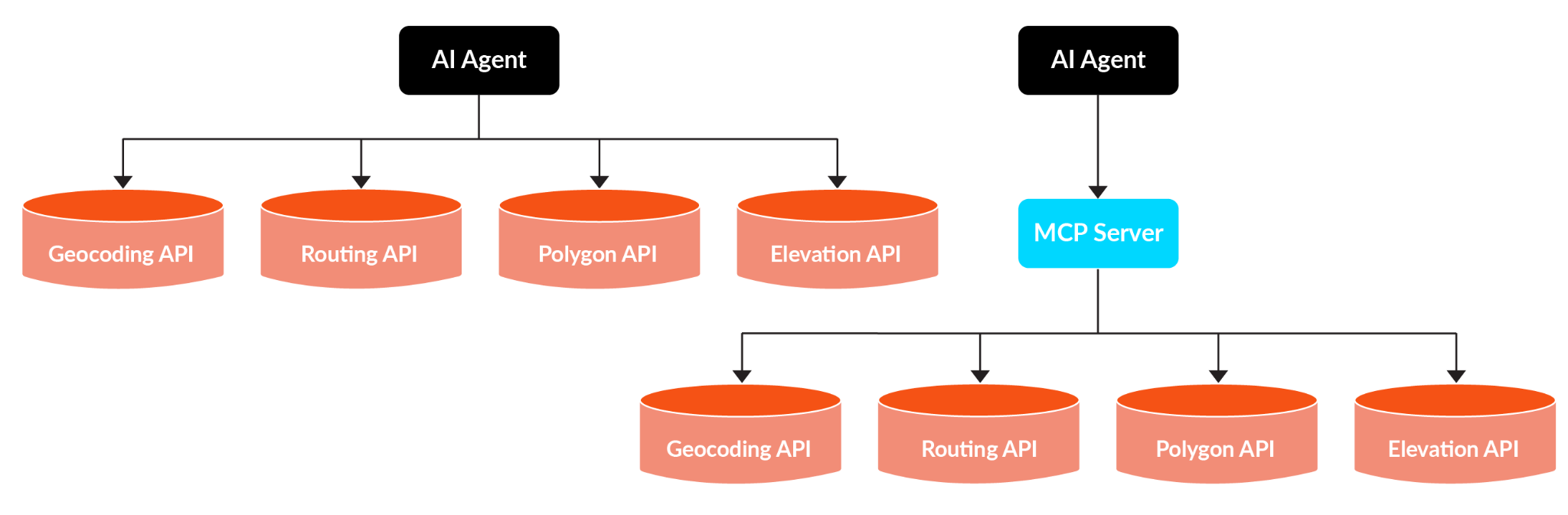

 Fragmented direct API calls versus a governed MCP interface
Without a shared standard, each spatial API becomes an independent integration with no consistency or traceability. To illustrate how quickly this becomes unmanageable, consider how three common geocoding services return the same data point.

Three commercial providers, three different JSON paths for the same coordinate. Add a legacy municipal database returning a different CRS entirely, and the agent has no reliable way to reason over the results without custom parsing logic for each source.
The observability problem compounds the issue. With no instrumentation in this setup, platform teams cannot trace which spatial tool ran, what inputs it used, or why it failed. When a routing result comes back wrong, there is no audit trail connecting the geocoded input to the engine’s output. Errors become extremely hard to diagnose, especially when multiple agents are hitting the same spatial services with different expectations.
Enterprise spatial data makes this worse. Municipal systems and legacy databases return inconsistent field names, mixed coordinate reference systems, and colloquial location inputs that vary by region. When this unfiltered data reaches the LLM, the result is degraded reasoning and hallucinated spatial logic. For example, an agent asked to find the nearest warehouse might return a facility 100 miles away because it silently mixed up coordinate systems with no validation layer to catch the mistake.

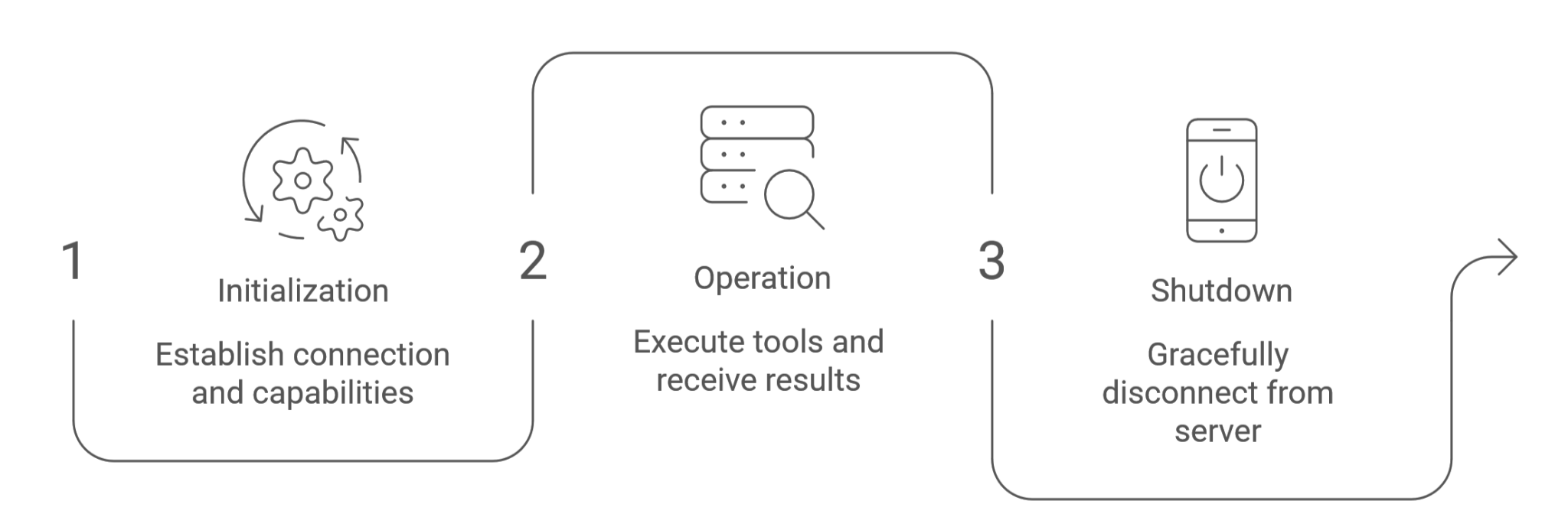

The protocol follows a three-phase connection lifecycle:
  1. Initialization: The server publishes its available tools so the agent (or any MCP client) can discover what it can call dynamically.
  2. Operation: The agent sends JSON-RPC requests to invoke those tools.
  3. Shutdown: The connection closes cleanly.
This lifecycle means agents never need hardcoded knowledge of what tools exist—they discover capabilities at runtime.
The MCP client-server connection lifecycle.

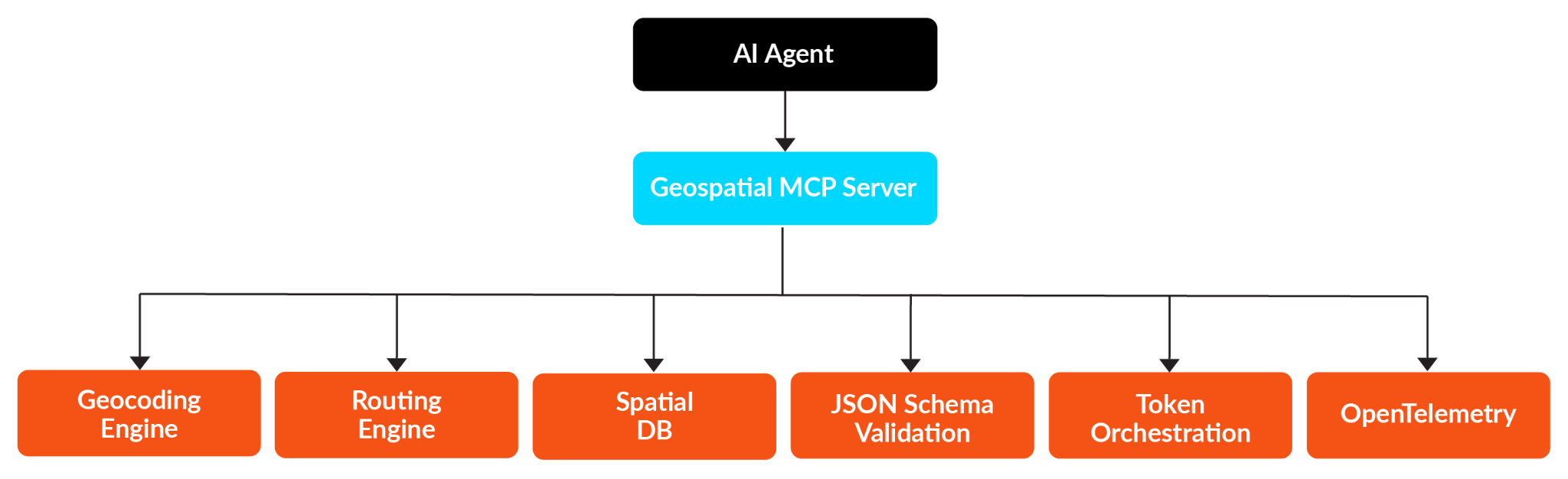

A geospatial MCP server is not a pre-built product; it is an MCP server you implement and configure specifically for spatial operations. In a nutshell, it is an MCP server capable of specialized spatial operations. Instead of the agent calling raw GIS APIs directly, it calls purpose-built tools exposed by the server, and all the underlying complexity, coordinate transformations, schema differences, and projection handling are abstracted away behind a validated interface.
The actions that a geospatial MCP server could perform typically include operations like reverse_geocode(coord) for translating coordinates to human-readable locations, find_nearby(lat, lon, radius, type) for proximity searches, route(origin, destination, constraints) for path calculation, and spatial join  for containment queries. A practical rule of thumb: If implementing a capability correctly requires GIS domain knowledge, it belongs in the server, not the agent.
Anatomy of a geospatial MCP server and its engine layer.

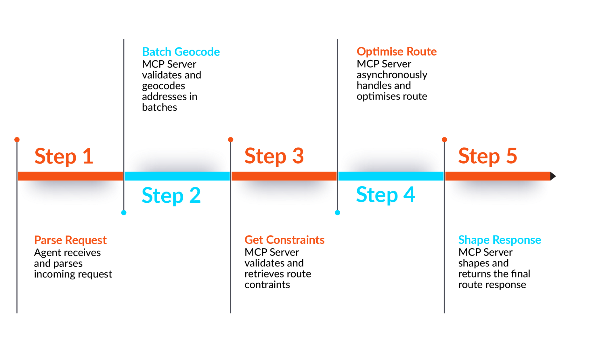

The workflow proceeds through five execution steps, each showing what the MCP server handles versus what runs in the spatial engine layer behind it.
Token-gated workflow across the MCP server and engine layer
Step
What the agent does
What the MCP server owns
What the engine layer runs
1. Parse RequestExtracts intent from natural language
2. Batch GeocodeCalls batch_geocodeValidates addresses, normalizes input, returns tokenThe geocoding engine resolves coordinates
3. Get ConstraintsCalls get_road_constraints (gated on geocode token)Validates token, structures constraint dataSpatial DB returns restrictions
4. Optimise RouteCalls optimise_route (gated on both tokens), polls for resultReturns task handle, runs asyncThe routing engine computes the optimal path
5. Shape ResponsePresents the result to the dispatcherFormats output to the expected schema
Responsibility is split across the five workflow steps.
Step 1: Natural Language Request. A dispatcher types: “Optimize tomorrow’s route for truck 14 across all 40 delivery stops, avoiding restricted bridges.” The LLM parses this into a structured intent and identifies the MCP tools needed.
Step 2: Batch Geocoding. The MCP server’s batch_geocode tool receives the 40 addresses, normalizes them, and returns validated coordinates with a completion token. The server owns the input validation and schema normalization; the geocoding engine (Google Maps, Mapbox, or an on-premise service) runs behind it.
Step 3: Constraint Retrieval. The MCP server’s get_road_constraints tool, gated on the geocoding token, queries a spatial database for bridge weight limits and time-based access restrictions along candidate corridors. The server validates and structures the constraint data; the spatial database handles the query.
Step 4: Route Optimisation. The MCP server’s optimize_route tool, gated on both the geocoding and constraint tokens, runs asynchronously. It passes the coordinates and constraints to a routing engine. The MCP server returns a task handle; the agent polls for the result. This is where clean separation matters most: the routing engine (whether OSRM, Valhalla, or a commercial solver) can be swapped without changing the agent or the MCP contract.
Step 5: Shaped Response. The MCP server formats the optimized route into the agent’s expected output schema: ordered stops, estimated arrival times, flagged constraints, and total distance. The agent receives structured, validated data and presents it to the dispatcher.
Throughout this workflow, the MCP server is the governed interface. It validates inputs, enforces execution order through tokens, delegates heavy computation to specialised engines, and structures outputs for the agent. Every step is instrumented and auditable.

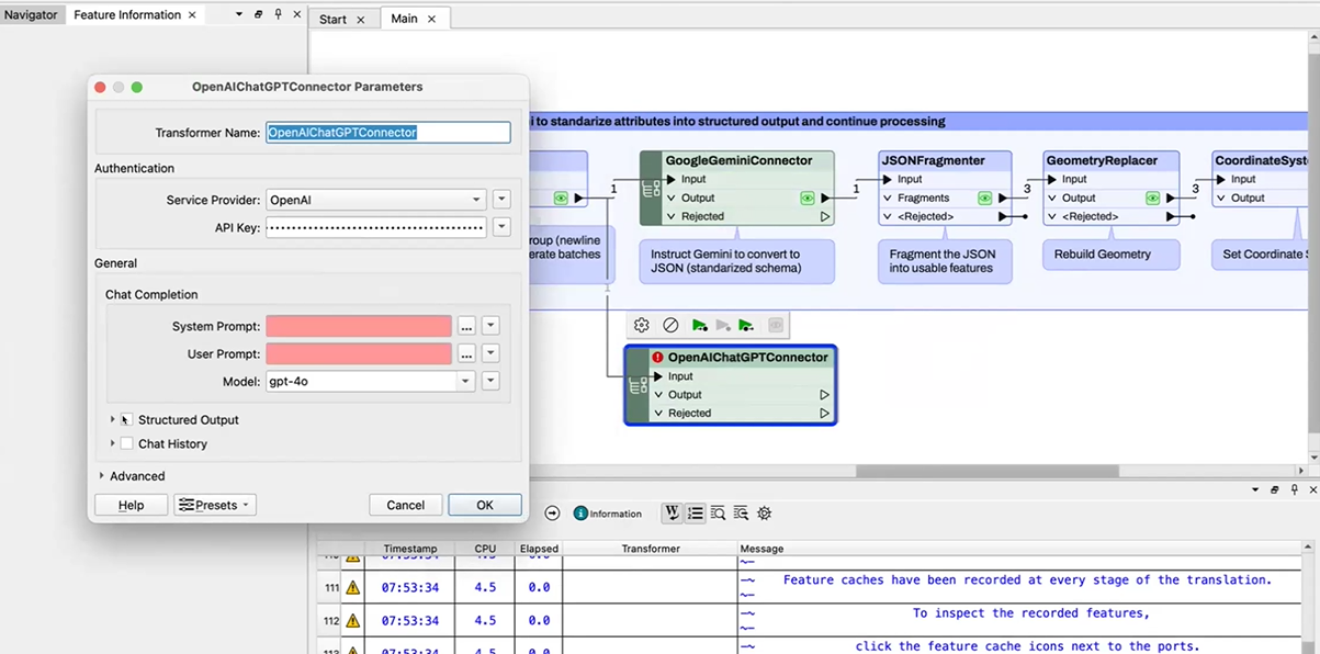

In the logistics scenario, the upstream normalization step (standardizing the 40 delivery addresses, reprojecting coordinates to WGS 84, validating geometry) maps directly to an FME workflow published as an MCP tool. The route optimization step, which runs asynchronously, maps to a second FME workflow handling the heavy computation behind the MCP server’s task handle.
FME also includes the MCPCaller transformer, which allows FME workflows themselves to call external MCP servers, making it possible to build bidirectional integrations where FME both exposes and consumes MCP tools. For teams already running spatial data pipelines in FME, this means the path to a governed geospatial MCP server is shorter than building from scratch.
FME Form’s no-code workspace for building spatial data workflows.
