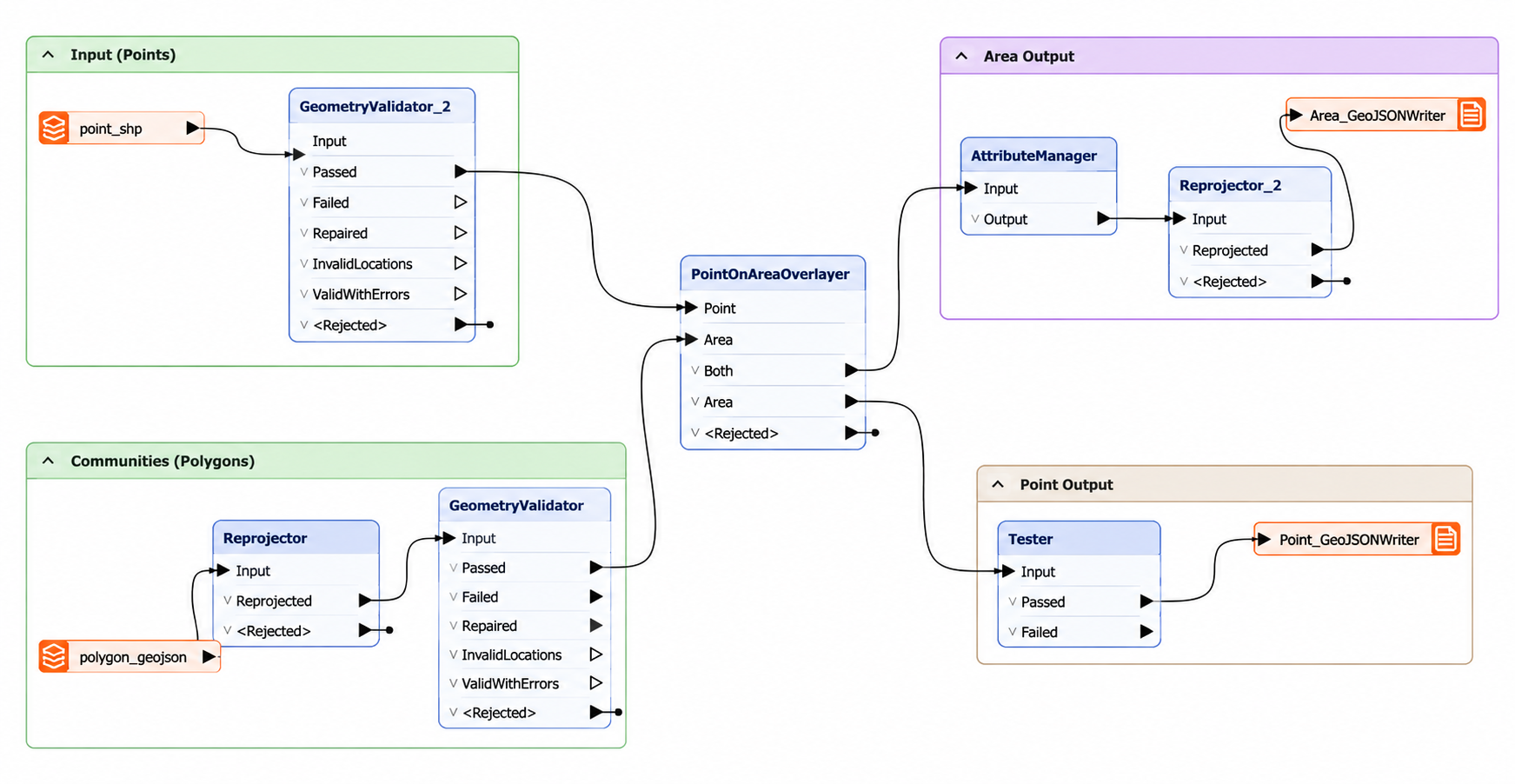

Recreating the workflow in FME Form
An equivalent analytical procedure can also be depicted as a visual flowchart instead of being translated to Python code. Here, programmatic spatial analysis in GeoPandas is compared to a no-code option in FME Form, a spatial ETL platform whose visual authoring environment is called FME Workbench.
FME Form implements the same workflow through visual programming in a workspace. Readers, transformers, and writers are linked via a canvas instead of code statements. For teams whose GIS work is outside a Python codebase, this can be a better way to create and transfer work.
Here is a walkthrough for an equivalent workspace:

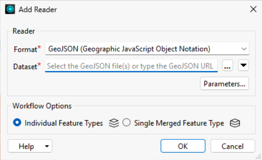

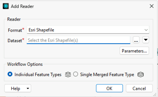

  1. Add the polygon and point datasets as Readers.
Add a GeoJSON Reader for the polygon dataset and an Esri Shapefile Reader for the point dataset. For each Reader, select the appropriate source file.

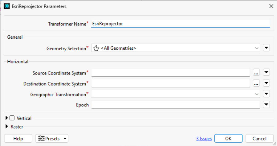

  1. Align the coordinate reference systems.
Add an Esri Reprojector to the dataset requiring transformation. Set the source CRS to that of the incoming data, set the target CRS to that of the other layer, and set geographic transformation to none. Resolve the coordinate reference system disparity between the data to be compared spatially.

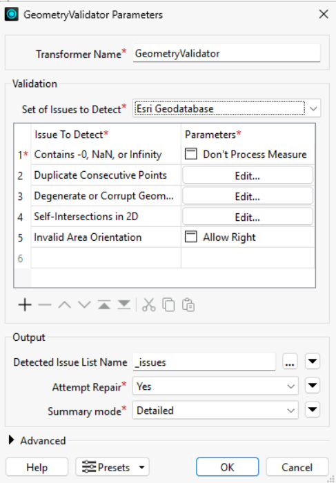

  1. Validate the input geometry.
Append the polygon features to a GeometryValidator. Set the “Set of Issues to Detect” option to Esri Geodatabase. Configure the GeometryValidator to validate the presence of invalid geometry, such as self-intersection. If applicable to the data, set the Attempt Repair option, which will allow the Validator to correct invalid geometry(i.e., set the Attempt Repair option to No for point geometry).

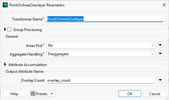

  1. Perform the point-in-polygon operation.
Connect the point and polygon features to a PointOnAreaOverlayer. This component validates point locations within polygon areas, transfers relevant features, and generates an overlap indicator showing how many points correspond to each polygon.

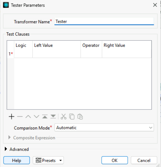

  1. Separate matched and unmatched points.
Send the point output from the PointOnAreaOverlayer to a Tester. Configure the Tester to utilize the output of the PointOnAreaOverlayer to divide the set of points that are associated with a polygon from those that are not. This ensures unmatched points are not discarded, allowing other analyses of these points.

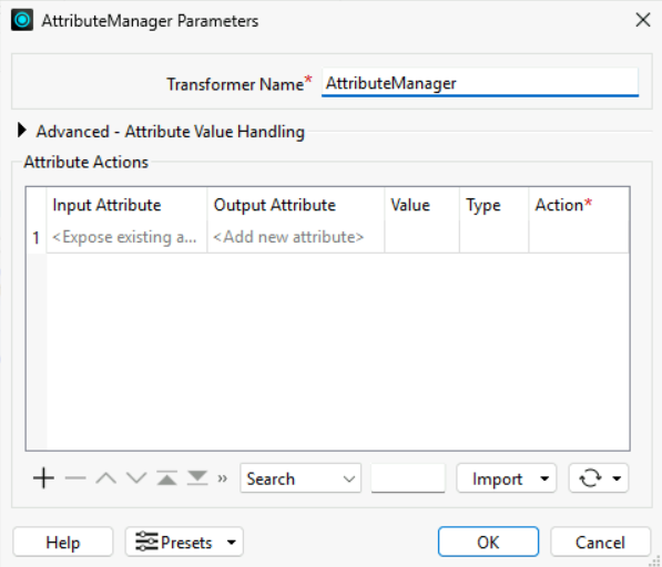

  1. Set up polygon output attributes.
Connect the area output to an AttributeManager. Retain the polygon ID, polygon name, count of the points, and any other relevant fields for the output dataset. Delete or rename the remaining fields.

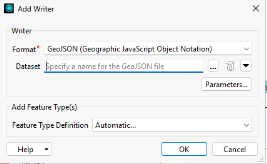

  1. Prepare and write the final GeoJSON output.
For web mapping, the completed polygon summary should be in EPSG:4326. Revisit step 2 for Esri Reprojection before you set up a GeoJSON Writer, specify the folder location and the final polygon output.
The completed workspace also brings together the same major operations as in the previous section: reading the datasets, harmonizing their coordinate reference systems, validating geometries, analyzing point-to-polygon relationships, isolating points, and creating a summary of polygons as GeoJSON.
[Figure: FME Workbench workflow for aligning, validating, matching, counting, and exporting point and polygon data.]
