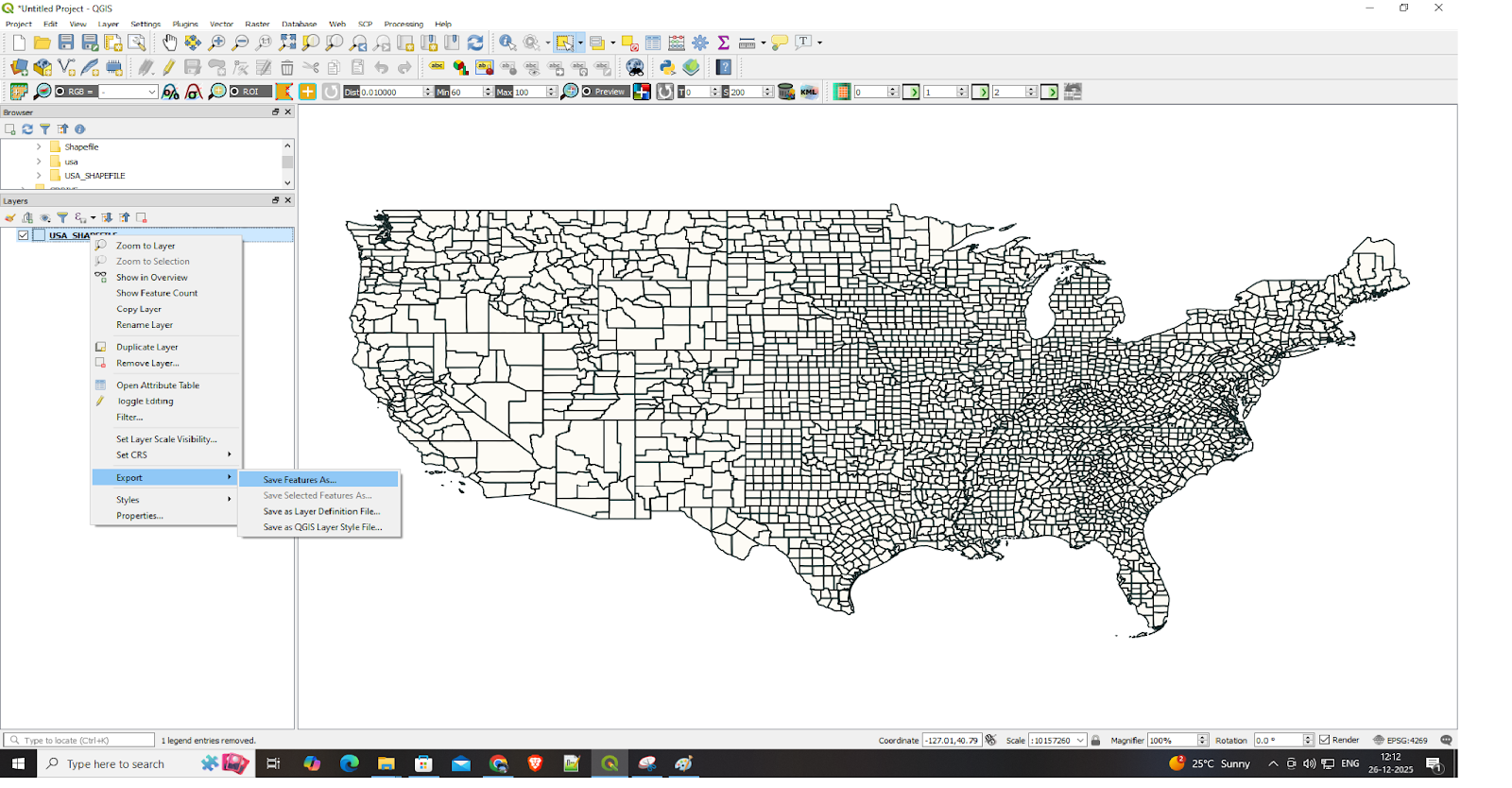

Method #1: QGIS (the beginner quick guide)
QGIS is a widely used open-source GIS platform. The program allows users to experience the same functionality as digital sandbox operations through very simple steps. The tool works best for single-conversion tasks that don’t require basic Python functionality.
Here’s the step-by-step guide:

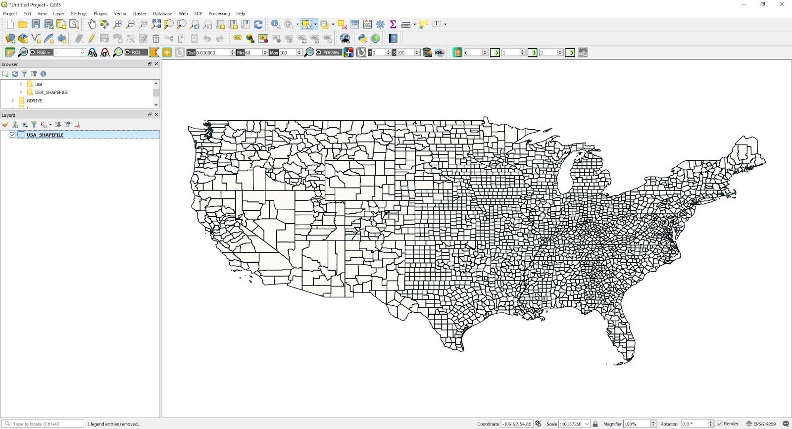

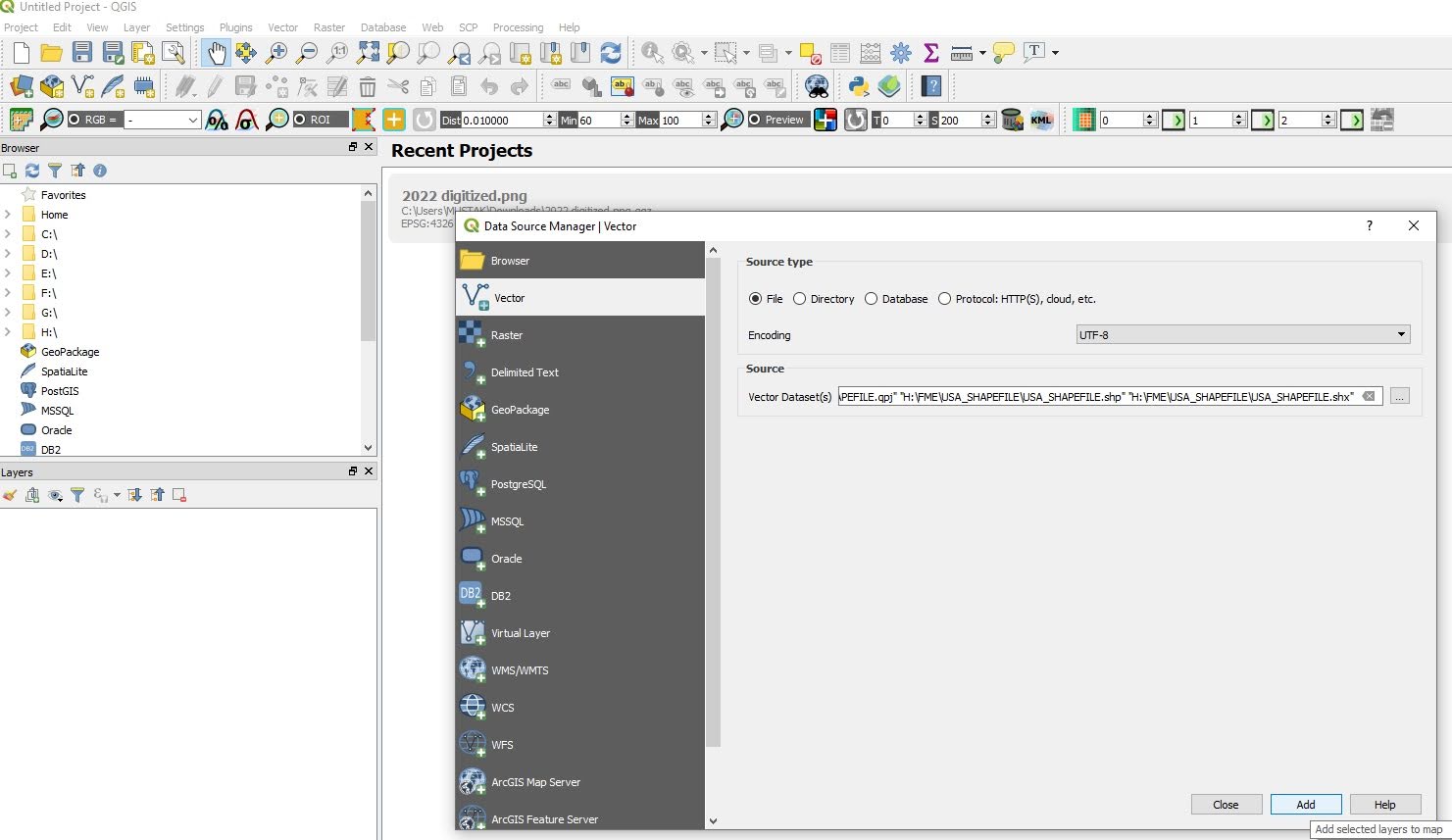

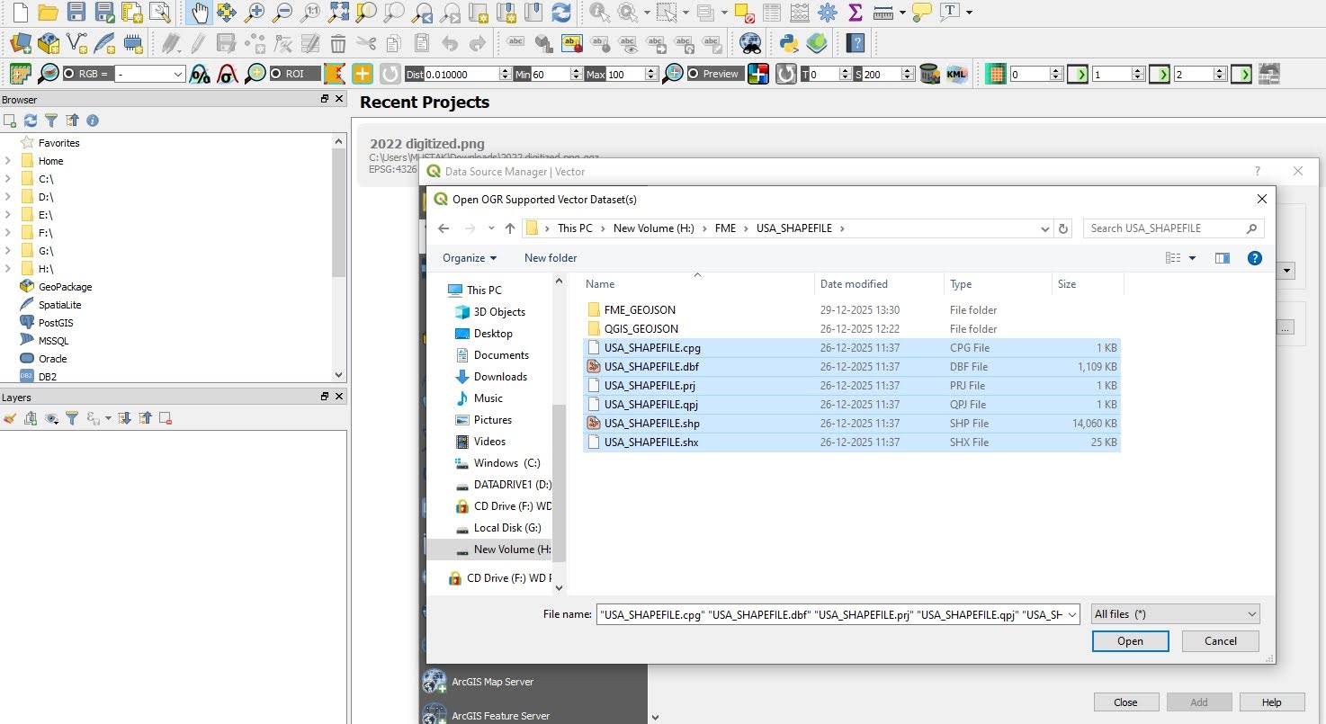

  1. Run QGIS (don’t worry if you don’t have it installed yet; it’s very easy to download).

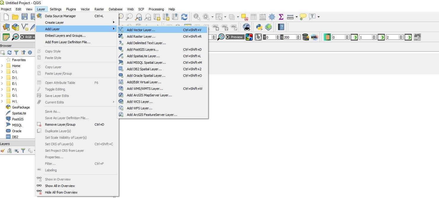

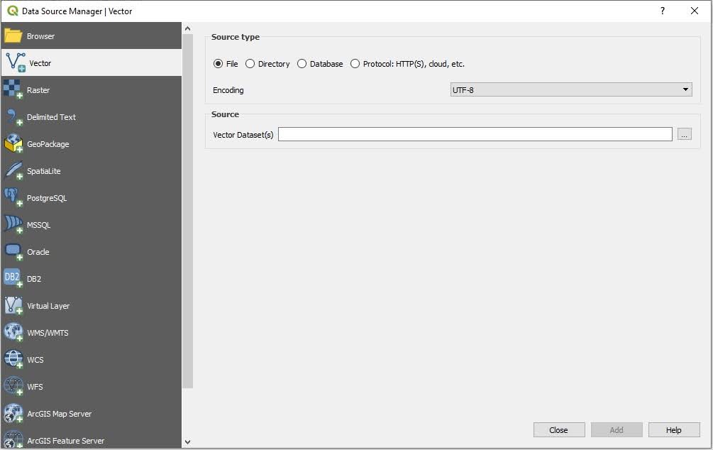

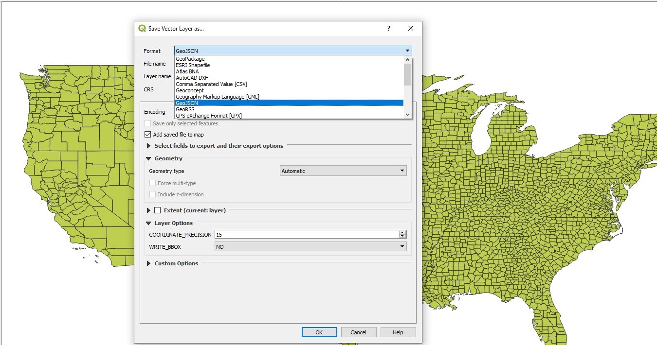

  2. Select the following options from the menu bar:  Layer > Add Layer > Add Vector Layer and then click on your shapefile.

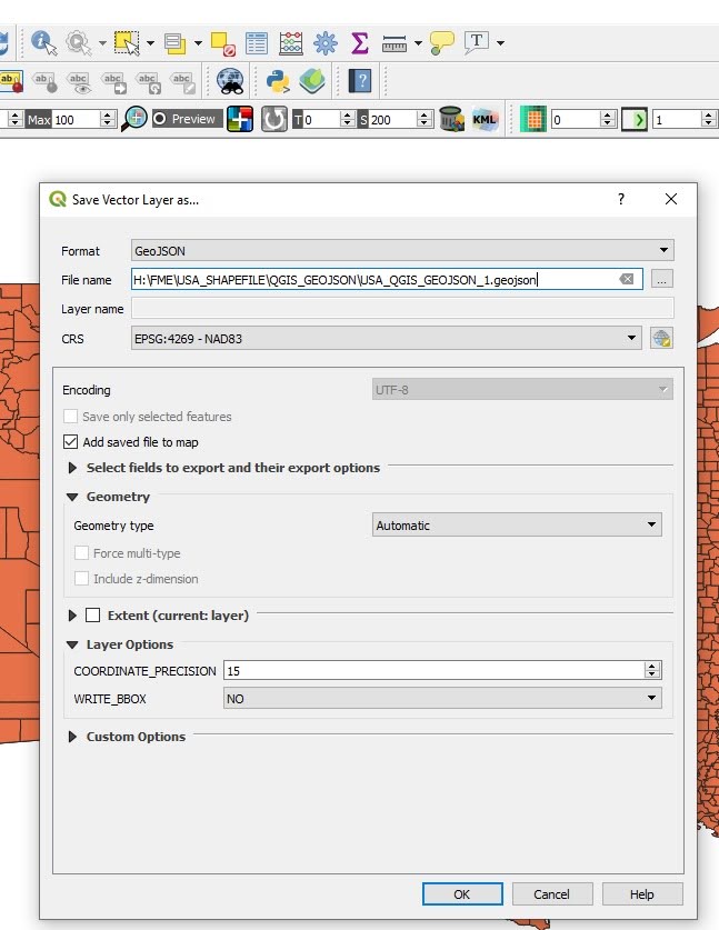

  1. Right-click the layer in the panel to access the Export function: Export > Save Features As.…
  1. Select GeoJSON from the dropdown menu and choose EPSG:4326 (WGS 84) as your CRS before selecting your save location and clicking OK.
Your GeoJSON file becomes available for web map integration after you finish the process. The user interface presents a straightforward design that brings me satisfaction.

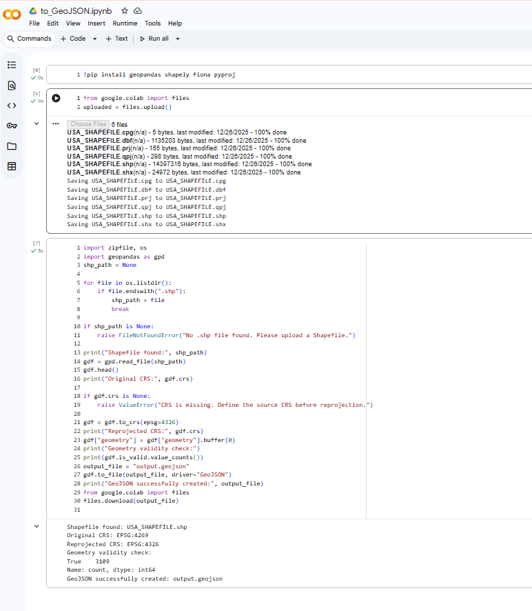

Step-by-step in Colab:
  1. Start by setting up a Python environment where the script can run that supports geospatial libraries such as GeoPandas and Fiona. Create a new notebook that you can start using.
  2. Install the required libraries.
!pip install geopandas shapely fiona pyproj
  1. Upload your zipped shapefile: .shp, .shx, .dbf, .prj.
from google.colab import files
uploaded = files.upload()
  1. Import libraries.
import geopandas as gpd
import os
A Python package called GeoPandas was created to handle geographical data. Adding support for spatial data types and operations expands the capabilities of the pandas library, allowing users to read, write, manipulate, and analyze vector-based geospatial datasets. GeoPandas manages coordinate reference systems, geometry transformations, and attribute data within a single workflow and supports popular GIS formats such as Shapefiles and GeoJSON. The primary functions of loading the shapefile, handling geometries and attributes, and exporting the data to GeoJSON are all handled by GeoPandas.
  1. Locate the .shp file.
shp_path = None
for file in os.listdir():
    if file.endswith(".shp"):
        shp_path = file
        break
if shp_path is None:
    raise FileNotFoundError("No .shp file found. Please upload a Shapefile.")
print("Shapefile found:", shp_path)
  1.   Read the shapefile.
gdf = gpd.read_file(shp_path)
gdf.head()
  1. Check and reproject the CRS to WGS 84.
print("Original CRS:", gdf.crs)
if gdf.crs is None:
    raise ValueError("CRS is missing. Define the source CRS before reprojection.")
gdf = gdf.to_crs(epsg=4326)
print("Reprojected CRS:", gdf.crs)
  1. Fix invalid geometries.
gdf["geometry"] = gdf["geometry"].buffer(0)
print("Geometry validity check:")
print(gdf.is_valid.value_counts())
  1. Export and download.
output_file = "output.geojson"
gdf.to_file(output_file, driver="GeoJSON")
print("GeoJSON successfully created:", output_file)
files.download(output_file)

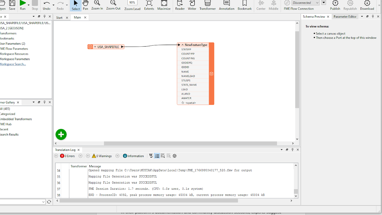

Method 3: FME (the “no-code hero” that is about to change your workflow)
The Python method above provides excellent reproducibility because you can share your notebook to start working with others right away. But, what if CRS mismatches or package version issues start coming up? If you want a process that is free from import errors—and who doesn’t?—the FME method is for you.
The Feature Manipulation Engine (FME), developed by Safe Software, is a data integration platform designed to extract, transform, and load (ETL) both spatial and non-spatial data. It supports a wide range of geospatial formats and provides robust capabilities for data conversion, validation, reprojection, and transformation within a single workflow.
FME uses a visual, drag-and-drop interface that allows users to build complex data pipelines without writing code. It can efficiently process large datasets and is commonly used in enterprise environments where scalability, automation, and data reliability are critical. These capabilities make FME well-suited for organizations that need to manage large volumes of geospatial data, support team-based workflows, and avoid maintaining custom scripting solutions.
FME offers multiple benefits:
  • It’s very dependable: No more “invalid polygon” nightmares, thanks to automatic geometry validation.
  • Scalability: It easily integrates with AWS, ArcGIS, or PostGIS to process thousands of files in a single night. Additionally, you can have an API for the files.
  • Customization: You can modify attributes, make shapes simpler, or even add custom transformers without writing code.
  • Convenience: It’s possible to construct reusable workspaces that operate according to schedules, converting one-time tasks into automated workflows.
The interface of FME Workbench offers straightforward functionality.

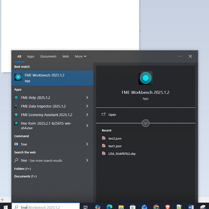

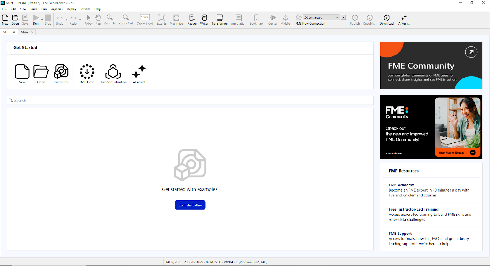

  1. Launch FME Workbench (safe.com offers a free trial, if needed).

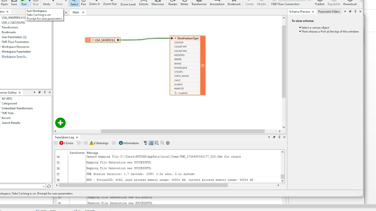

  1. Click New, then choose your file by dragging it into a Shapefile Reader.
  1. Select the ESRI shapefile format. Keep everything as the default.
  1. To automatically fix any design flaws, the Geometry Validator should be included.

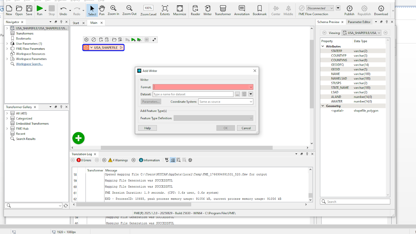

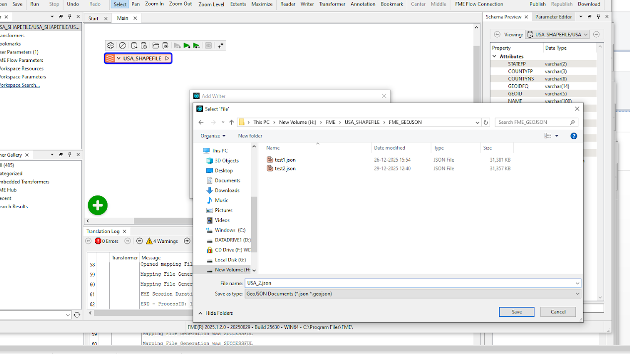

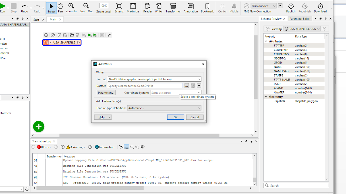

  1. Now, add a Writer by clicking Writer, selecting GEOJSON as your format, and then clicking Save and selecting the desired drive. Keep others as the default.
  1. Before beginning the Run process, you must connect to a GeoJSON Writer. Select the reader, and a line will come out and join it to the Writer.
  1. To learn about the writer’s built-in features, the integrated Data Inspector needs to be thoroughly examined.

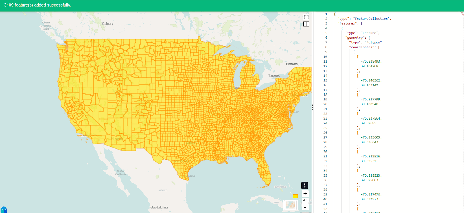

  1. You will see the save.GeoJSON file at your save location.
Run the file once, save the workspace, and you’ve got a repeatable recipe. FME enables you to transform complete municipal data collections for web portal implementation without any failures. Curious? The documentation and community discussion sections of the FME platform contain valuable information that will help you use FME to its fullest.
