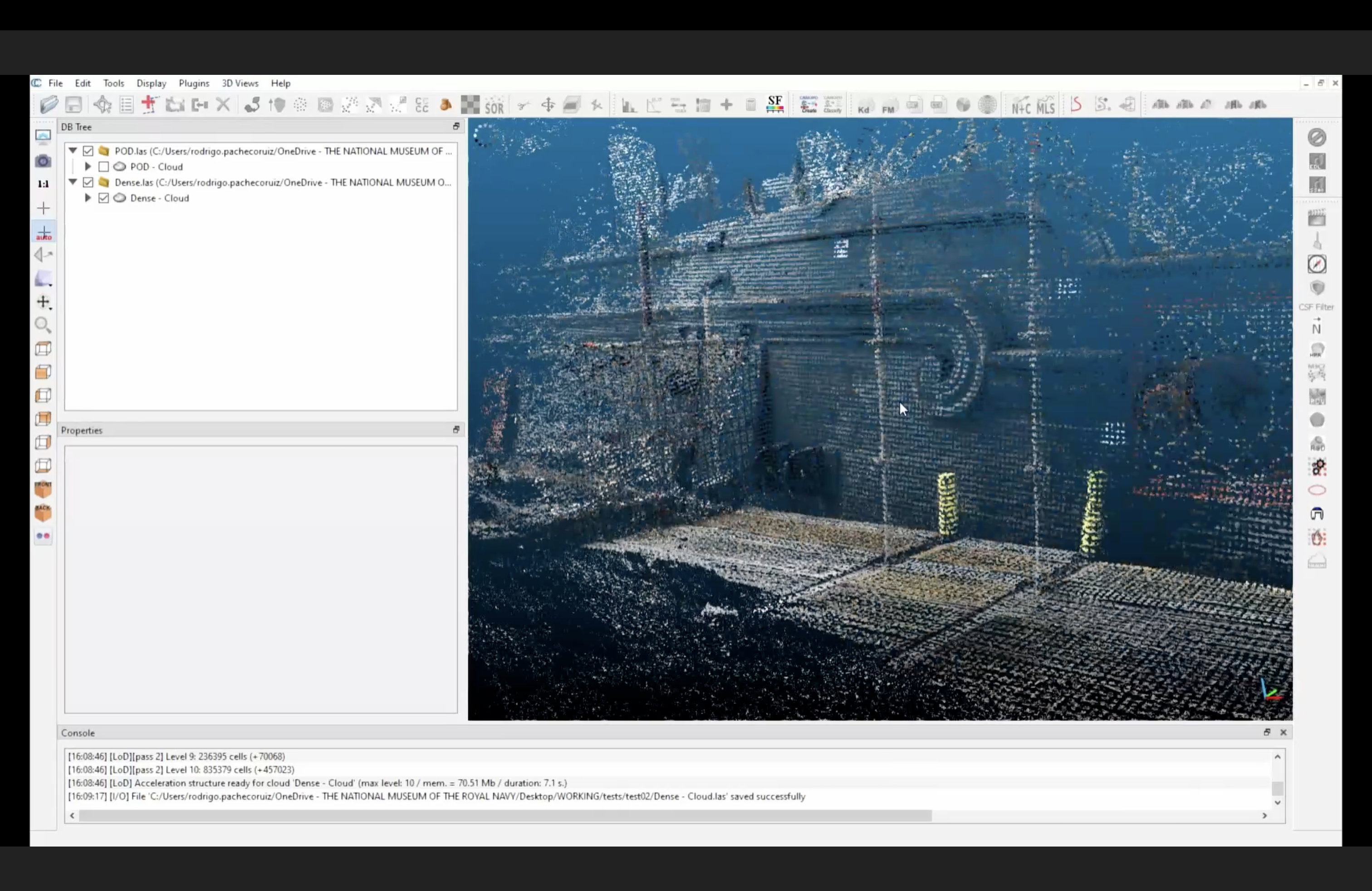

A digital twin to preserve history: HMS Victory
HMS Victory, launched in 1765 and Lord Nelson’s flagship at Trafalgar in 1805, is the oldest commissioned warship in the world, now undergoing one of the largest conservation projects of her life. The National Museum of the Royal Navy is documenting every structural change in meticulous detail.
The team chose FME to collect and standardize the data needed to reconstruct and document the work, building 4D models (three dimensions plus time) that let them examine repairs digitally without disturbing the ship’s historic fabric. A twin already exists, though changes are still entered manually; the aim is to use FME to automate the links between its Revit model, Rhino, and an SQL database so it stays current. A digital twin is not only for things being built, but for things that already exist and need to be preserved.
Read more: Restoring HMS Victory with 4D modelling and FME
Screenshot: Media: Dr. Rodrigo Pacheco-Ruiz, National Museum of the Royal Navy
