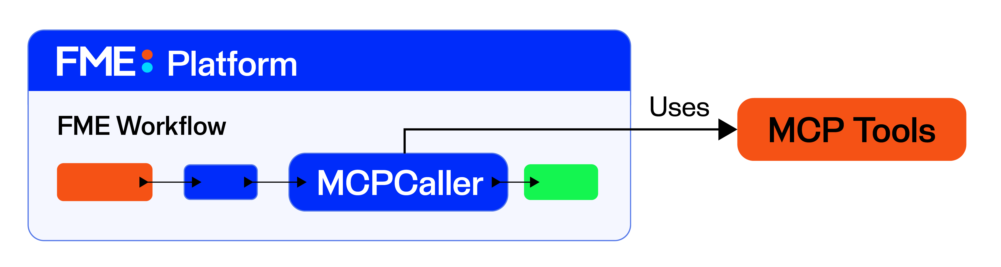

Conversely, the MCPCaller transformer lets an FME workspace consume tools from any MCP server, choosing the tool at authoring time or letting the workspace select tools at runtime. Any system that publishes an MCP interface becomes something FME can reach, which means every MCP-publishing system effectively joins the FME ecosystem.

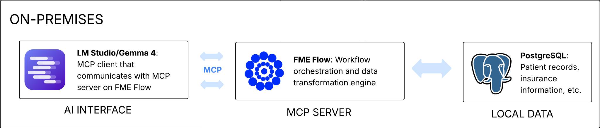

Keeping everything inside the firewall
The strongest version of this pattern runs entirely on-premises. The AI model, the MCP client, and the MCP server all live inside your network, so no data crosses onto the internet. This is what makes the approach viable for regulated or sensitive data and air-gapped environments: if nothing leaves, compliance is built into the architecture.
A typical local stack pairs an MCP-compatible client such as LM Studio, Goose, or Ollama with an open-weight model you can run yourself, such as Google’s Gemma or Alibaba’s Qwen family, both freely available. The client connects to your FME Flow MCP server using the server’s URL, which FME generates for you when you create the server. Paste that URL into the client’s configuration, and the tools appear, ready to call.
For example, say you want to validate CAD files that sit on a local file share. A natural-language instruction can drive the relevant tool(s) in sequence, with the model breaking the request into steps and calling each workspace in turn. FME runs the validation and returns a structured JSON summary of what passed and failed, which the model can then answer follow-up questions about. The CAD files never leave the network; only the results you chose to return reach the client.

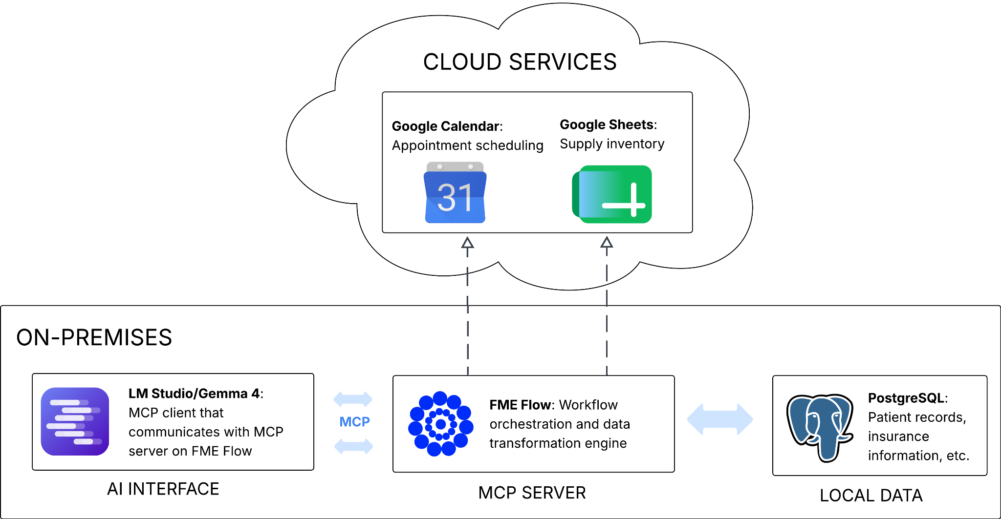

Filtering data at the source (FME as the Data Guardian)
Many real workflows have to connect to the outside world in some way, but the principle still holds: expose only what’s necessary.
For example, consider scheduling appointments at a medical clinic where patient records live in a database mixing sensitive and non-sensitive fields. The workspace can query the database but select only the fields a calendar event needs while leaving sensitive details behind. Or for data that contains precise addresses, you can anonymize the geometry by snapping each point from its precise address to the midpoint of its street block. With FME as the controlled boundary, only specific data and attributes goes out through an API call, and sensitive data never reaches the AI or the cloud service.
  • Best-case scenario: never let sensitive data enter the workspace. Use a SQL query that selects only the needed columns, so sensitive fields are eliminated at the point of access. They cannot leak because they were never loaded.
  • Next best: remove sensitive attributes mid-workflow. If they have to enter the workspace for processing, strip them (for example, with an attribute-removing transformer) before the results are formatted for the client.
  • Last line: expose only chosen attributes at the output. Control what the reader or the MCP Writer sends back, so only the fields you explicitly listed reach the model.
