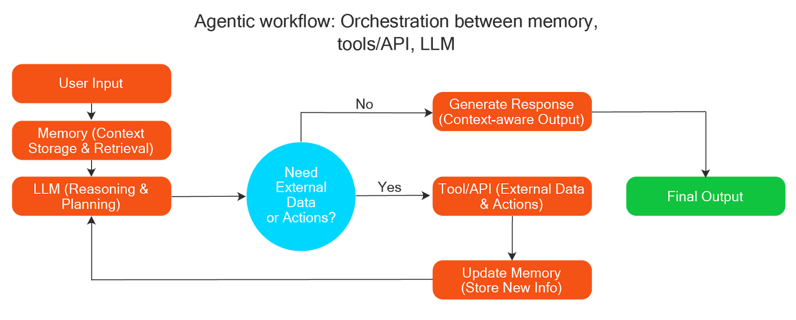

Below is an example of a workflow using a single agent orchestrating memory and a decision block for routing to an external tool or generating an output.

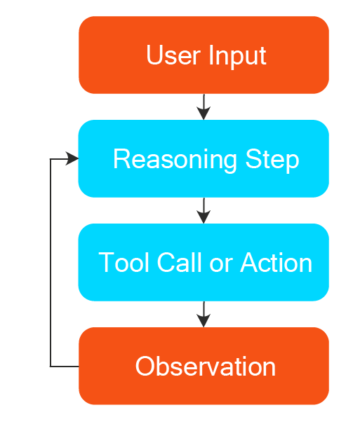

ReACT (Reason, Act, and Observe) is one such typical decision-making pattern widely used for building autonomous agents. ReACT loops enable agents to think before they act. They iteratively reason about the current state, determine the following action, execute it, and observe the result.
This loop continues until a final response or decision is made. It reflects how agents alternate between thinking and acting.
For example, when answering the question “What is the weather in London and do I need an umbrella?”, the agent follows this loop:
  • Reason: I need to get the current weather of London to answer this question.
  • Act: Call a weather API for London.
  • Observe: The API returns “light rain”.
  • Reason: Since it is raining, the user might need an umbrella.
  • Act: Respond to the  user’s question, suggesting taking the umbrella

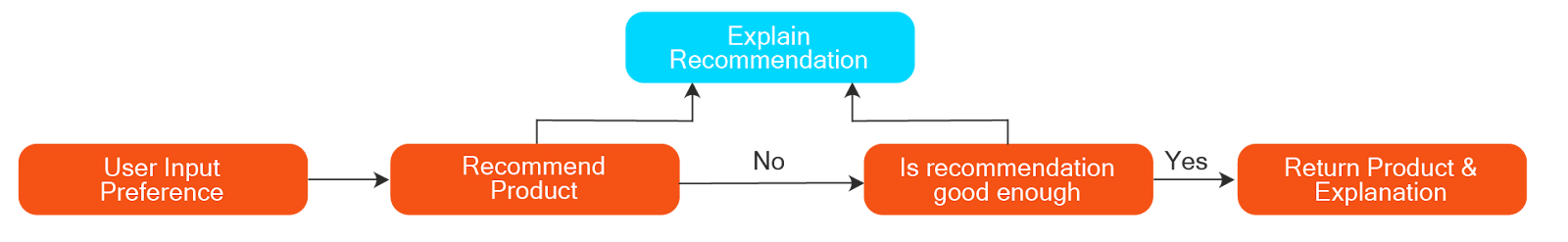

Our code example uses LangGraph nodes, states, and edges to create the workflow. The state evolves as the workflow progresses till the task is completed. The agent re-routes to finding the recommended product if the best match is not found.

The above code showcases an agent recommending a product. The execution process begins with initial input, specifying a given preference: “outdoor adventure and hiking.” At each node, the LLM is invoked to update the state according to the node’s functionality. At Node 3, a quality check is done using the state. If passed, a product is recommended; otherwise, the process is routed back to the recommended node.
