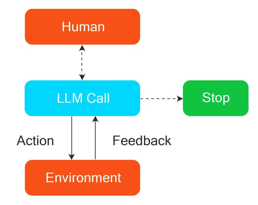

Understanding AI agent architecture
AI agents are autonomous systems that can execute complex logical tasks on behalf of a user by retrieving additional information, recalling historical interactions, and programmatically invoking external tools to take action, as illustrated below.
The AI agent concept
The AI agent concept (source)

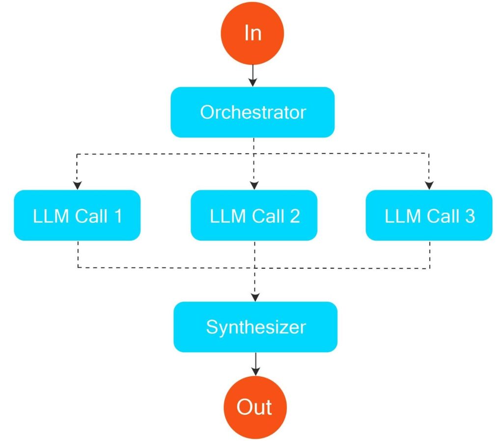

AI agents differ from workflows that rely on programmatically specified and predefined logical flows using LLMs, like the example below, where pre-determined logic breaks down tasks, dispatches prompts to LLMs in parallel, and synthesizes the result.
The orchestrator-workers workflow
The orchestrator-workers workflow (source)

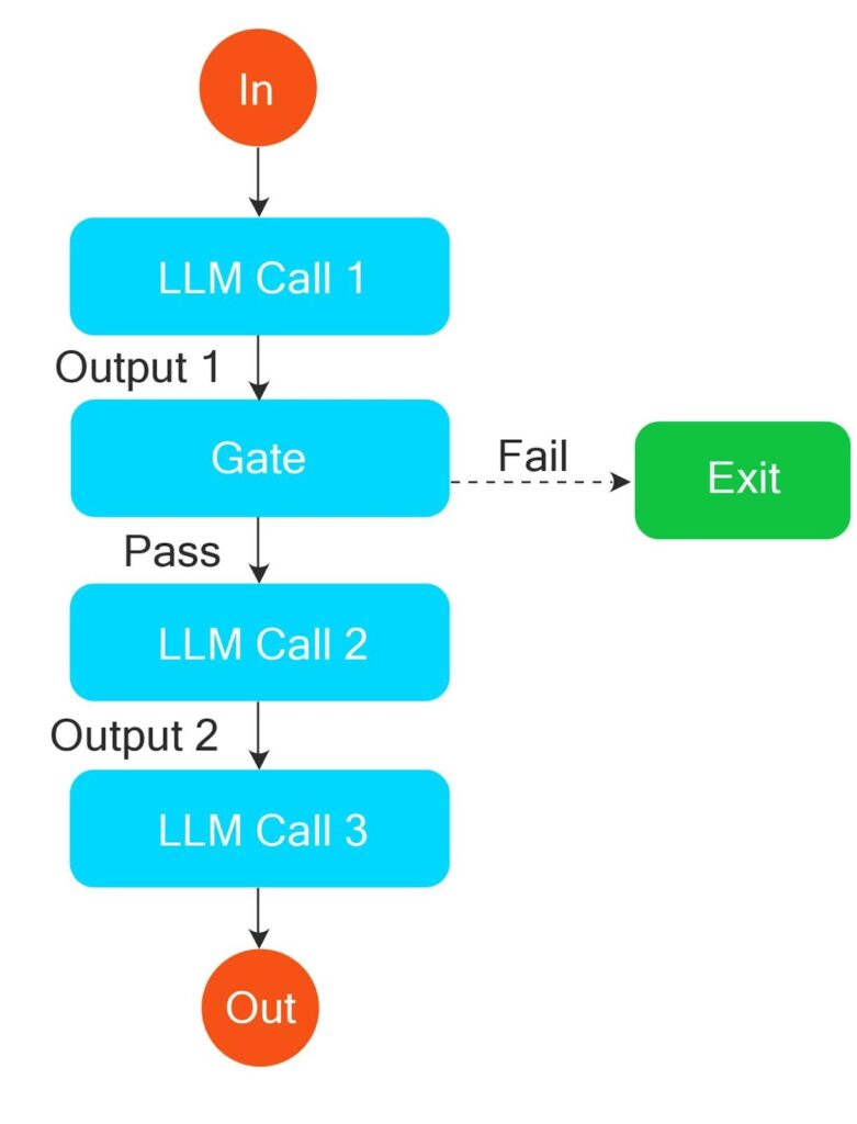

Pre-determined workflows don’t always call LLMs in parallel, they might do so I sequentially using the prompt chaining technique, where the output of one LLM is fed as input to another specialized LLM, as shown below.
The prompt chaining pattern
The prompt chaining pattern (source)

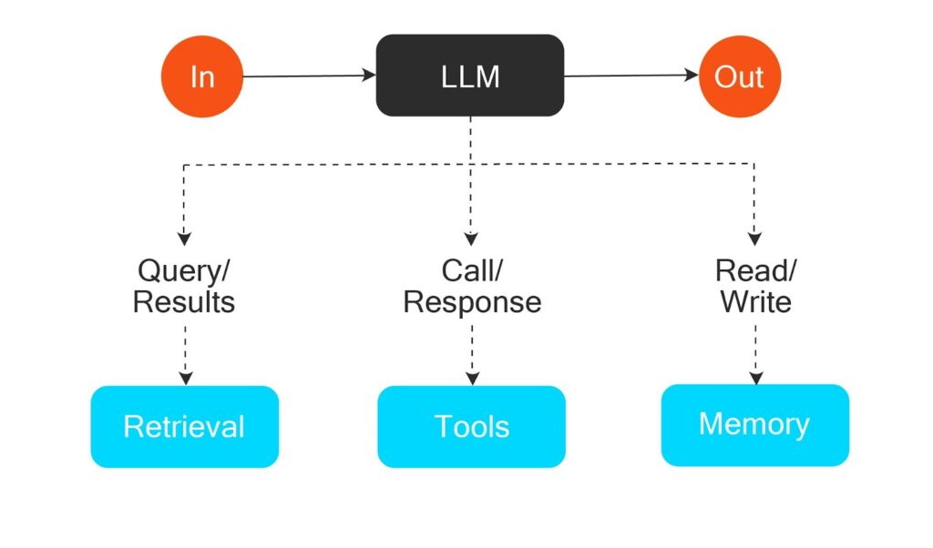

AI agents, on the other hand, can independently decide the number of steps and the sequence of their execution. Unlike workflows, their execution sequence is not predefined. Hence, agents can be used for open-ended problems where it is difficult to map the execution steps and their sequence beforehand, as illustrated below.
The AI agent architecture
The AI agent architecture (source)

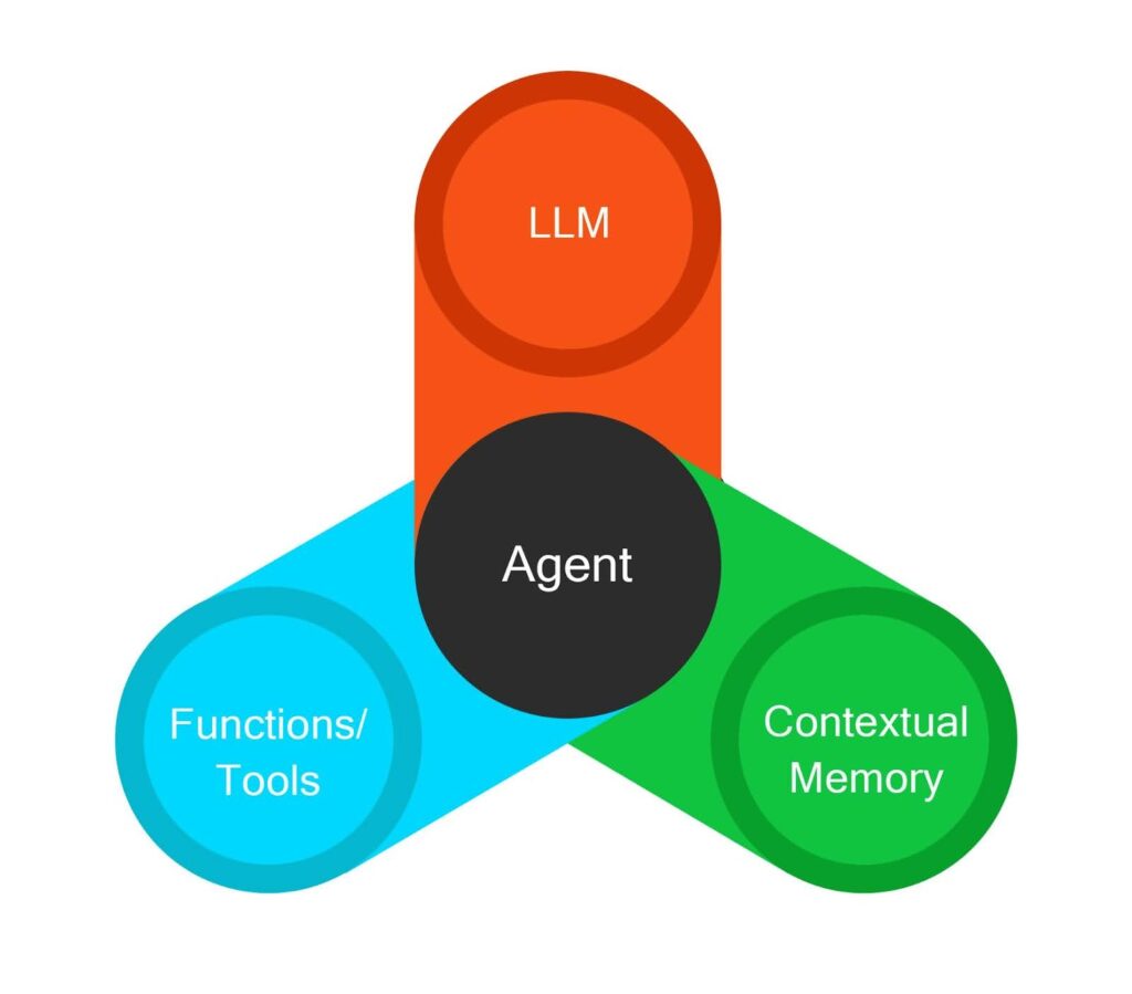

Key components of AI agents
Broadly speaking, an AI agent has three key components.
LLMs
LLMs provide the intelligence for the planning and execution of tasks. LLMs receive the user input and create a plan of the sequence of actions needed to achieve the user’s goal. Based on the Agent’s implementation logic, there may be recursive calls to LLMs to figure out the individual tasks within a larger task, the sequence of execution, and the feeding of output to other child tasks.
Contextual Memory
Contextual memory stores information about the previous steps executed by the agent. This is important in patterns where an agent needs to refer to the outcome or state of a previous step before proceeding with its task. For example, consider a management assistant agent who answers questions about an organization’s sales and regions. A user can begin with the question “Which region had the lowest sales this month?” and then follow it up with “Which product had the highest sales in this region?”. Here, the agent will need a reference to the outcome of the previous question to process the question. Agents use short-term contextual memory to handle such requirements.
Contextual memory can also be long-term. For example, consider the same agent conversing with user A, who always asks questions about a particular region. That information can be stored in long-term memory as an area of interest for that user. Next time, if a question from the same user does not specify any region names, the agent can assume this region as the subject and confirm it.
Functions, API Calls, and Sub-agents
AI agents often need to access external systems to execute their tasks. They may need to fetch information from an external system, perform an operation using another system, or even delegate a task to another agent in a different domain. Such integrations are a key element of AI Agent architecture. For example, the assistant agent in the example may need to fetch information about sales from an external ERP platform. It may first fetch information about the logged-in user from an identity access management platform and then use an API from the inventory platform to query the information the user is privileged to access.
Of late, several frameworks have emerged to standardize function calling while building agents. Anthropic’s model context protocol (MCP) is a popular framework in this area. MCP is an open protocol that lets developers expose data and functionalities required by agents in a standard format.
Sub-agents are agents specialized in handling a specific domain or sub-task. They help to bring modularity within the AI agent architecture. Consider building functionality to suggest methods to improve sales within the assistant agent we discussed earlier. Building the data analysis and management reasoning functionality within the same assistant will make the logic overly complex. In all likelihood, this functionality will need a different LLM or a fine-tuned LLM. Such requirements are handled by building sub-agents that complement the main agent.

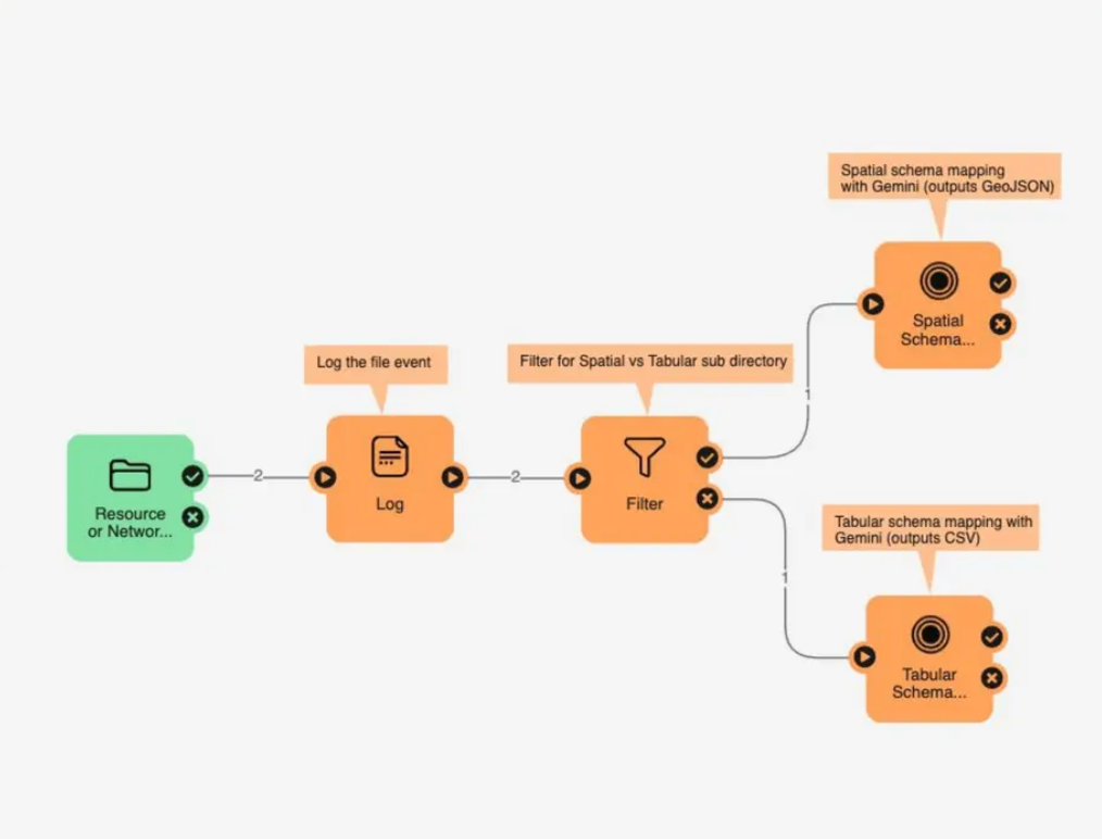

FME By Safe
FME is a no-code data platform that integrates enterprise data with AI. It is an Any Data All AI platform that lets developers build actionable insights with mouse clicks. Beyond relational and nonrelational databases, FME provides support for GIS, spatial data, and IoT technologies.
Typical enterprise requirements to integrate AI deal with processing large amounts of unstructured or structured data and then using the agents to make sense of it. This is where no-code platforms have an edge. If a simple example like fetching data from a hardcoded list took tens of lines of code with LangGraph, you could imagine the number of lines of code required to work with Geospatial data, transforming it into a standard format, and analyzing the data, all using LLMs.
With no-code platforms like FME, creating a data pipeline and feeding it into an LLM can be accomplished by defining visual workflows using built-in components and relying on LLMs to do the bulk of the work, as illustrated below.
Dynamic schema transformation using FME
Dynamic schema transformation using FME (source)
You can watch more about how FME helps Google to standardize geospatial data schema here.
