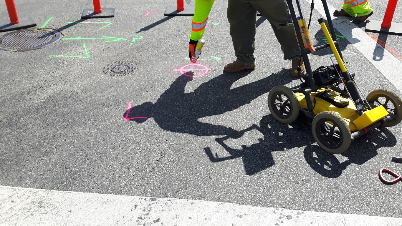

Technicians equipped with advanced locators collect precise pipe positions in the field. FME validates, imports, and updates GIS records from the cloud, supporting a smarter, data-driven locate process.
