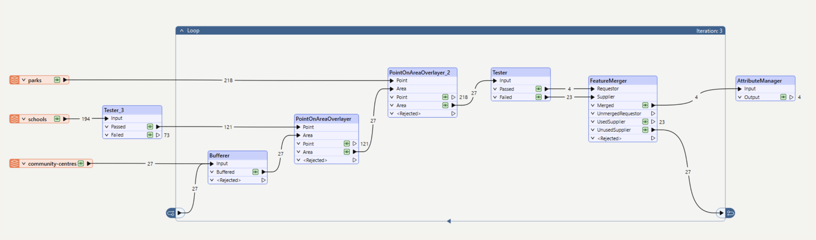

In FME 2026.1 and earlier, every loop had to live inside a custom transformer. In FME 2026.2+, a loop is simply a block on the main canvas. Select the transformers you want to repeat and click Loop on the toolbar (or press Ctrl+L, or right-click and choose Create Loop). Connect the input of the first transformer to the loop output port in the lower left of the block, and send any features that need another pass to the loop input port in the lower right. Features routed anywhere else leave the loop, and when no features come back to the loop input, the loop ends.

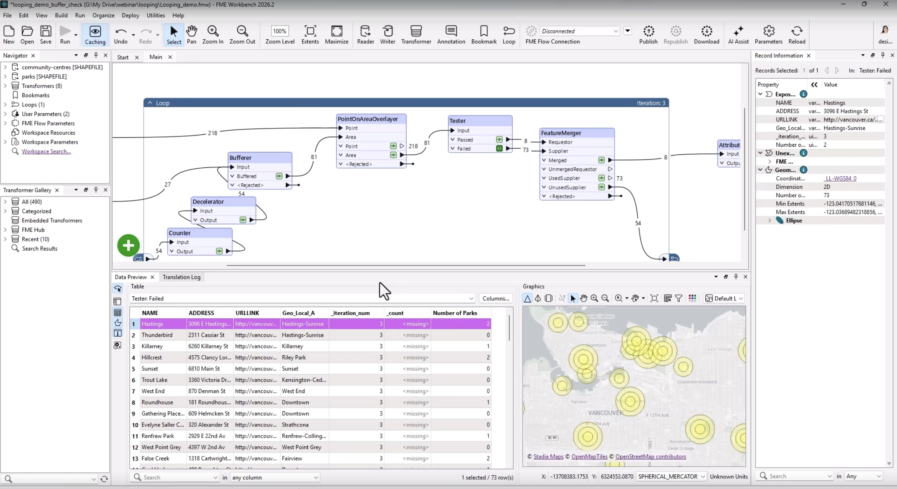

Changing a feature until it meets a condition. In this example, we buffer each community centre in a city, count the parks inside, and enlarge the buffer until it holds at least four. It’s a textbook “while loop” because you cannot know in advance how many passes each centre will need. Features that pass exit the loop; the rest go back with a larger radius. Live data caching (introduced in FME 2026.1) lets you open caches mid-run and watch the buffers grow, and a Decelerator slows things down enough to follow each pass.

- A low Loop Limit. Two or three passes while testing gets you output fast and exposes an accidental infinite loop in seconds.
- A Logger outside the loop. Read its output against _iteration_num to see exactly what each pass produced.
- The _iteration_num attribute. It is added automatically, and in Data Inspection it tells you which pass produced any given feature. That is usually the answer to “where did this weird record come from?”
- The live iteration count. It appears in the loop’s title bar as the workspace runs, so you always know where you are.
- The Decelerator. Loops can run faster than you can watch. Slow the flow down when you need to see what happens pass by pass.
- Disabling the loop. The mini-toolbar on the loop’s title bar can disable the entire loop, which quickly answers the question “is it the loop, or the workspace around it?”
One thing to keep in mind: feature count will not match iteration count. Five iterations can easily produce 34 features. The two numbers answer different questions, so do not infer one from the other; check _iteration_num instead.
