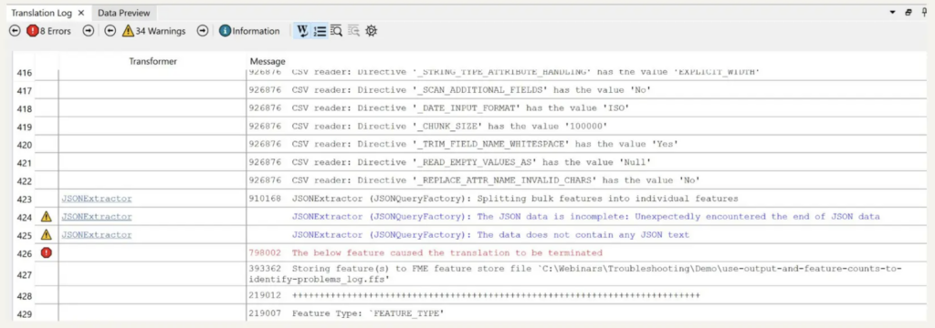

1. The Translation Log
Always begin with the log. It tells you where the issue occurred, which transformer was involved, and whether features were rejected. Warnings are particularly useful for solving mystery issues.
Also remember: a successful translation doesn’t guarantee correct output. The log confirms execution, not logic.

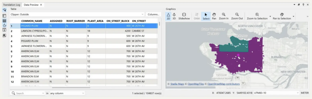

4. Data Preview
Use Data Preview to validate attribute values, geometry types, coordinate systems, and spatial alignment. Many spatial issues are projection mismatches, for instance. If two datasets don’t share the same coordinate system, spatial operations may return empty results without errors.
Previewing early prevents debugging later.

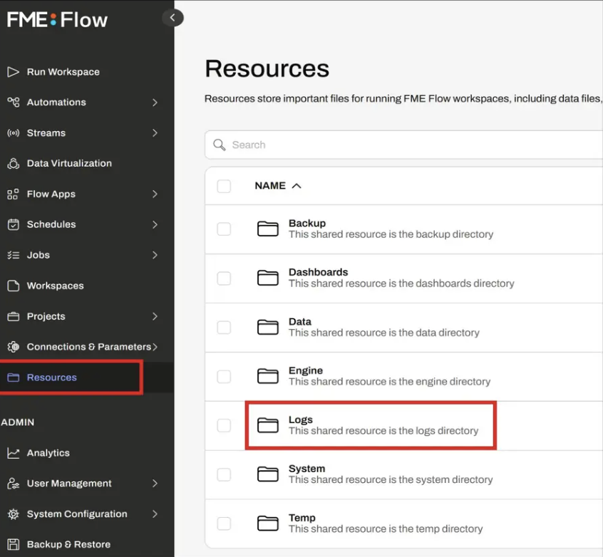

1. Job log
Start with the FME Flow job log. Scan it for missing file paths, permission errors, connection failures, or differences between environments.
A common example is local file paths. A file that exists on your desktop in Form won’t exist on the Flow server unless it’s uploaded or stored in a shared location. From Flow’s perspective, that path simply doesn’t exist.
