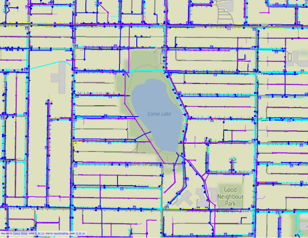

So I decided to go big. Why not try adding an entire city as an example? My first choice was obvious: Surrey, home of Safe Software HQ. But then, of course, COVID happened, and we were all suddenly working from home. So I pivoted to something closer to my doorstep — literally. The City of Coquitlam, just 500 meters away to the closest street, became my test ground. A short walk was all I needed for real-world testing. I grabbed open data shapefiles for all the utilities: simple 2D points and lines, the perfect sandbox to start with.
The first prototype workspace had around 50 transformers — modest by FME standards — and produced a flat 3D model. Flat, as in “no elevation changes,” which is mildly inconvenient when your test city is a literal mountainside. To avoid confusing perspectives of mismatching real and augmented worlds, I had to drive a bit more than half a kilometer to the patches where things looked believable. But step by step, the example grew.
I added surface draping, external styling (all colors defined neatly in a spreadsheet), and later, fancy HTML-based AR labels using whhtml2image. Before I knew it, the workspace had ballooned to nearly 300 transformers. At that point, it wasn’t just a prototype anymore, but a fully functional example.

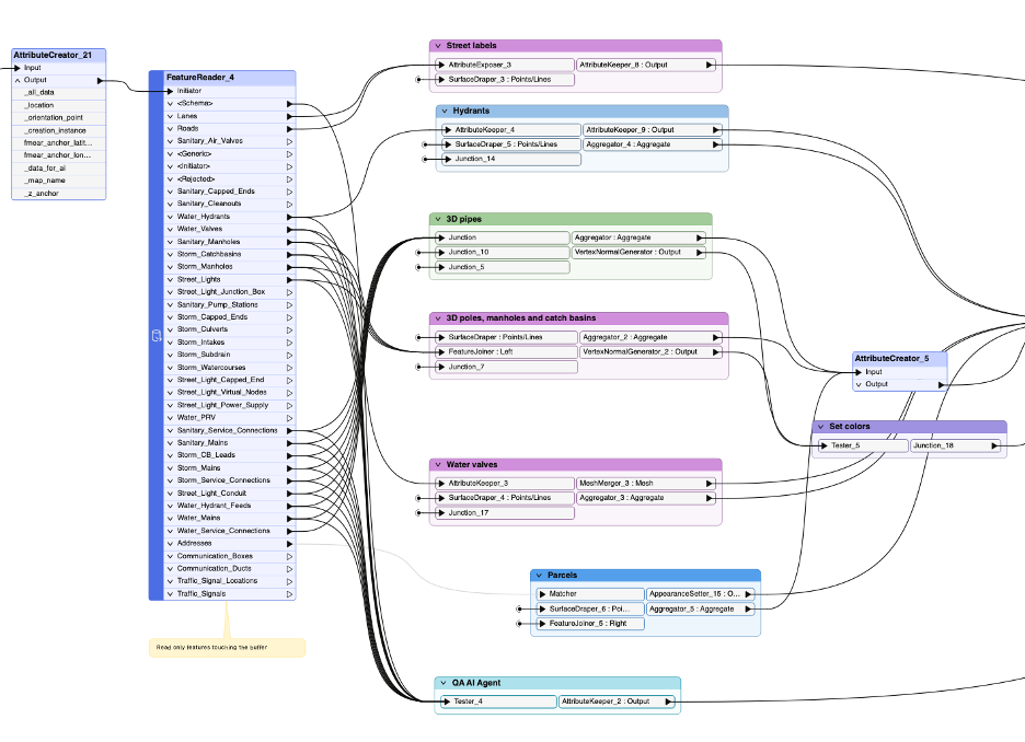

Originally, my workflow used a FeatureReader to bring the data in. The idea was simple: get the location from the device, buffer it, and send that buffer into the FeatureReader. The transformer would then return all the features within that buffer — everything from pipes to catch basins to street centerlines. It worked perfectly in theory.
In practice, though, it was a lot. Every feature type — every table, layer, or asset — came out of its own port. Forty layers meant forty output ports, which all needed to be connected, handled, cleaned, and standardized. And with each one came a pile of attributes, many of them irrelevant for the 3D model but still valuable for field users. So I had to choose: carry all that extra data through the workflow or spend time trimming it down. Neither option was particularly elegant.
The real challenge was consistency. Different data sources used different naming conventions for the same thing — for example, diameter could appear under six different attribute names. To generate 3D models correctly, I had to unify them; otherwise, every geometry creation step would turn into a small headache. And honestly, most of that work wasn’t about AR models at all — it was good old data cleaning and standardization.

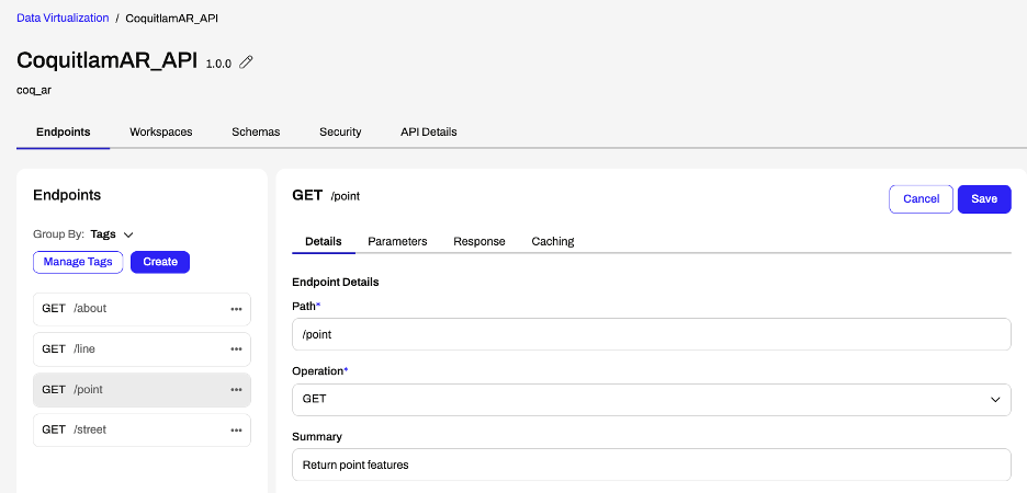

Data Virtualization, a new capability built entirely on the FME platform, takes away one of the biggest pains in complex projects: dealing with formats, connections, and authentication for every data source. It lets you create secure, OpenAPI-compliant REST APIs directly on top of your existing data — no extra infrastructure, no custom code. Each API endpoint (GET, POST, and so on) is powered by an FME workspace designed in FME Form and deployed in FME Flow, so everything follows the same no-code logic FME users already know. Behind a few simple API calls, it hides all the heavy lifting, such as authentication, permissions, caching, and the quirks of each format. In other words, your workspaces don’t need to know where the data lives or how to talk to it — they just ask for what they need.
By introducing Data Virtualization to my city-scale AR example, I was able to separate all that heavy lifting — data preparation, quality control, cleaning, and formatting — from the actual 3D model creation. The model-building workspace suddenly became lean and focused.

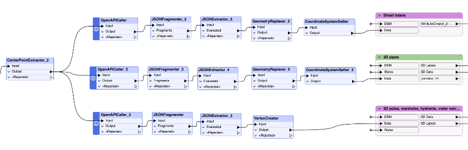

Instead of a massive FeatureReader, my workflow now relies on three OpenAPICallers:
  • One for lines (pipes and cables),
  • One for points (manholes, catch basins, valves, hydrants, etc.),
  • And one for street centerlines (because seeing street labels helps confirm you’re looking at the right place).
With that setup, I can start transforming data to 3D right away, with no extra data wrangling required. The workspace shrank from nearly 300 transformers down to about 180. Still a beast, but a much more elegant one.

But once I started, I realized that thanks to Data Virtualization, most of the heavy lifting was already done. All I needed was to adjust a few things in the workspaces behind the API calls — mainly accommodating Surrey’s naming conventions and adding a couple of new layers that didn’t exist in Coquitlam’s dataset.
I also added a simple logic tweak so the API workspaces could detect which database to read from. Now I have two databases — one for Coquitlam, one for Surrey. I created boundary polygons for both cities, and a quick overlay check determines which city the user’s location falls into. From there, the workspace simply writes one word — coquitlam or surrey — into the Data Virtualization API call. That’s it.
https://myar/api/coq_ar/point?x=-122.84&y=49.18&radius=60&city=surrey

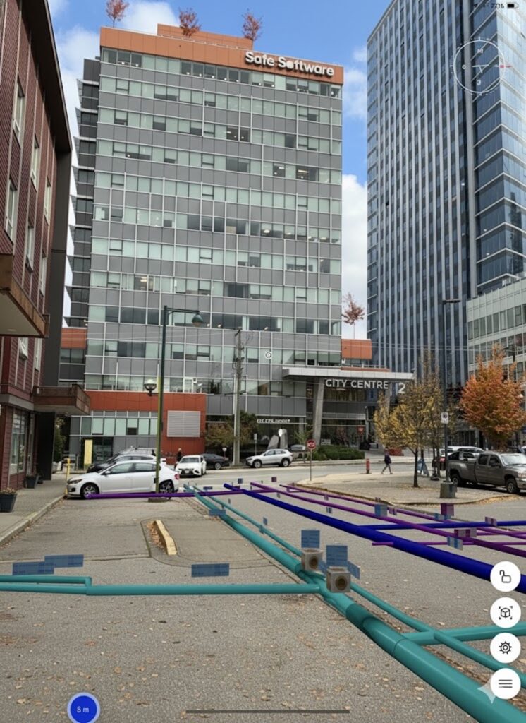

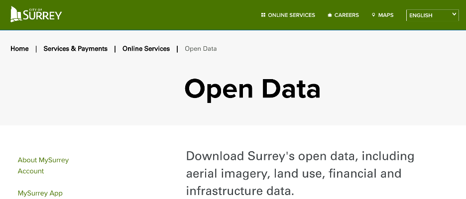

From the moment I started looking for open data to the moment I stood outside our office, viewing Surrey’s underground utilities in AR, only three hours had passed.
The Impact
When we stepped outside our office in Surrey and launched the new AR model for the first time, it felt like a full-circle moment. The same workflow that once took months of experimentation and debugging was now flexible enough to handle a completely new city with almost no effort.
