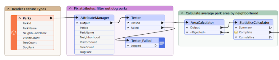

1. Use bookmarks and annotations to document what you’re doing and why you’re doing it. Don’t rename transformers, and don’t collapse bookmarks. Building workspaces that look neat and tidy is important.

5. Practice tidy, focused attribute management. Some users preferred to avoid the AttributeManager in favor of the AttributeRemover and other specialized attribute transformers. When using the AttributeManager, don’t overload it.
